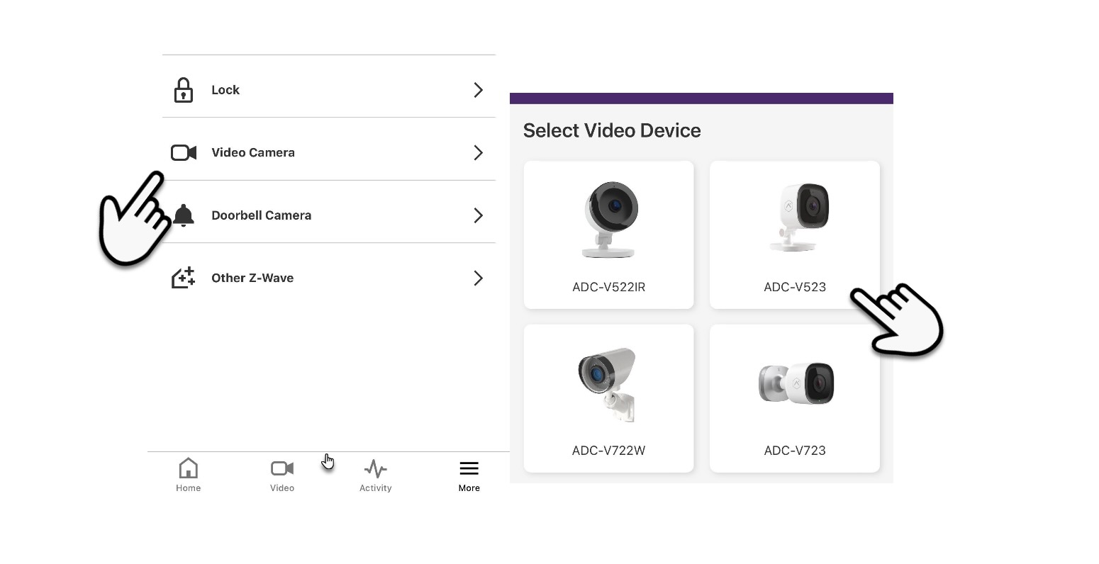

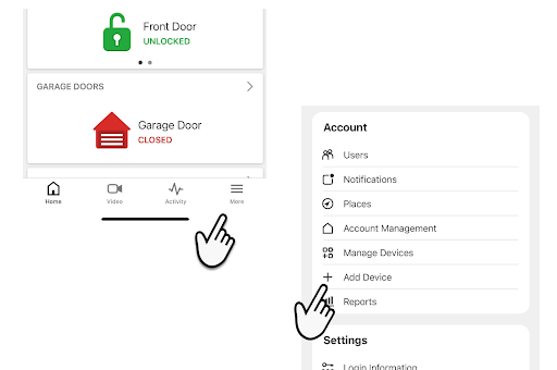

- Select Menu at the top left-hand corner
- Select + Add Device
- Select Video Camera
- Select Indoor Camera ADC-V523

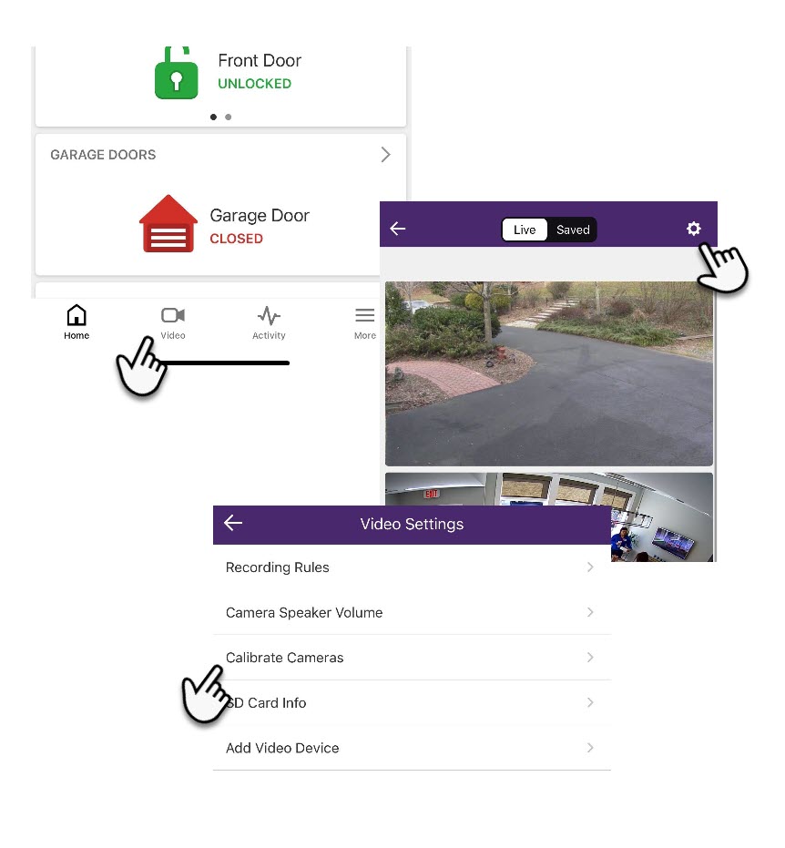

- Select Video
- Select the gear icon at the top right-hand corner
- Select Calibrate Cameras
- Follow the on-screen steps to complete the calibration of your camera
