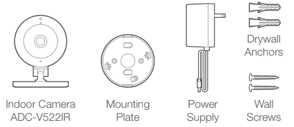

What's in the box?
- Indoor Camera ADC-V522IR
- Mounting plate
- Power supply
- Wall screws
You'll need:
- A smartphone or tablet
- 2.5 Mbps upload Wi-Fi
- Optional: Screwdriver, drill, pencil, 6mm (1/4 inch) drill bit

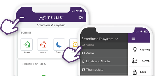

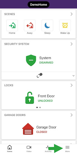

- Select Menu at the top left-hand corner

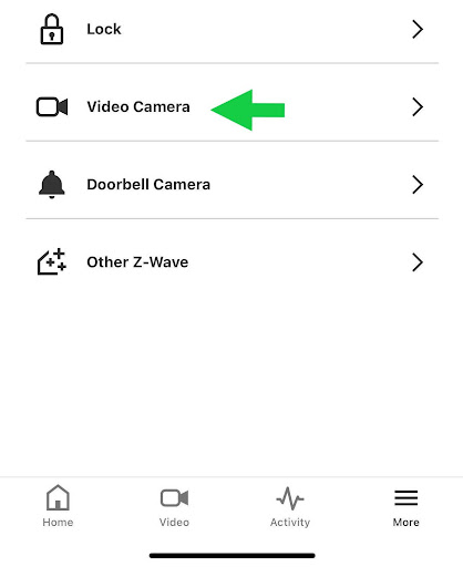

- Select + Add Device
- Select Video Camera
- Select Indoor Camera ADC-V522IR

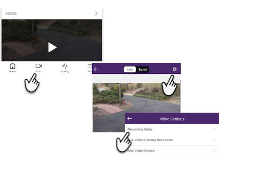

- Log in to your TELUS SmartHome app
- Select Video

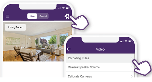

- Select the gear icon at the top right-hand corner
- Select Recording Rules
- Select Add New Rule at the top right-hand corner
