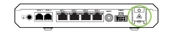

Locate the fibre cable with a green connector.
Remove the protective plastic cap from the tip of the green connector.
Lift the protection flap located to the right of the fibre terminal electrical port.
Align and insert the fibre cable into this port.
You must then plug an Ethernet cable into the "DATA 1" port of the fibre terminal.
You now need to plug the other end of the Ethernet cable to the back of your modem into the "WAN" port.
