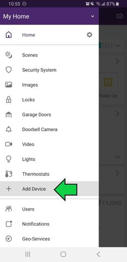

- Log in to your TELUS SmartHome app on your mobile device
- Select Menu at the top left-hand corner
- Select + Add Device

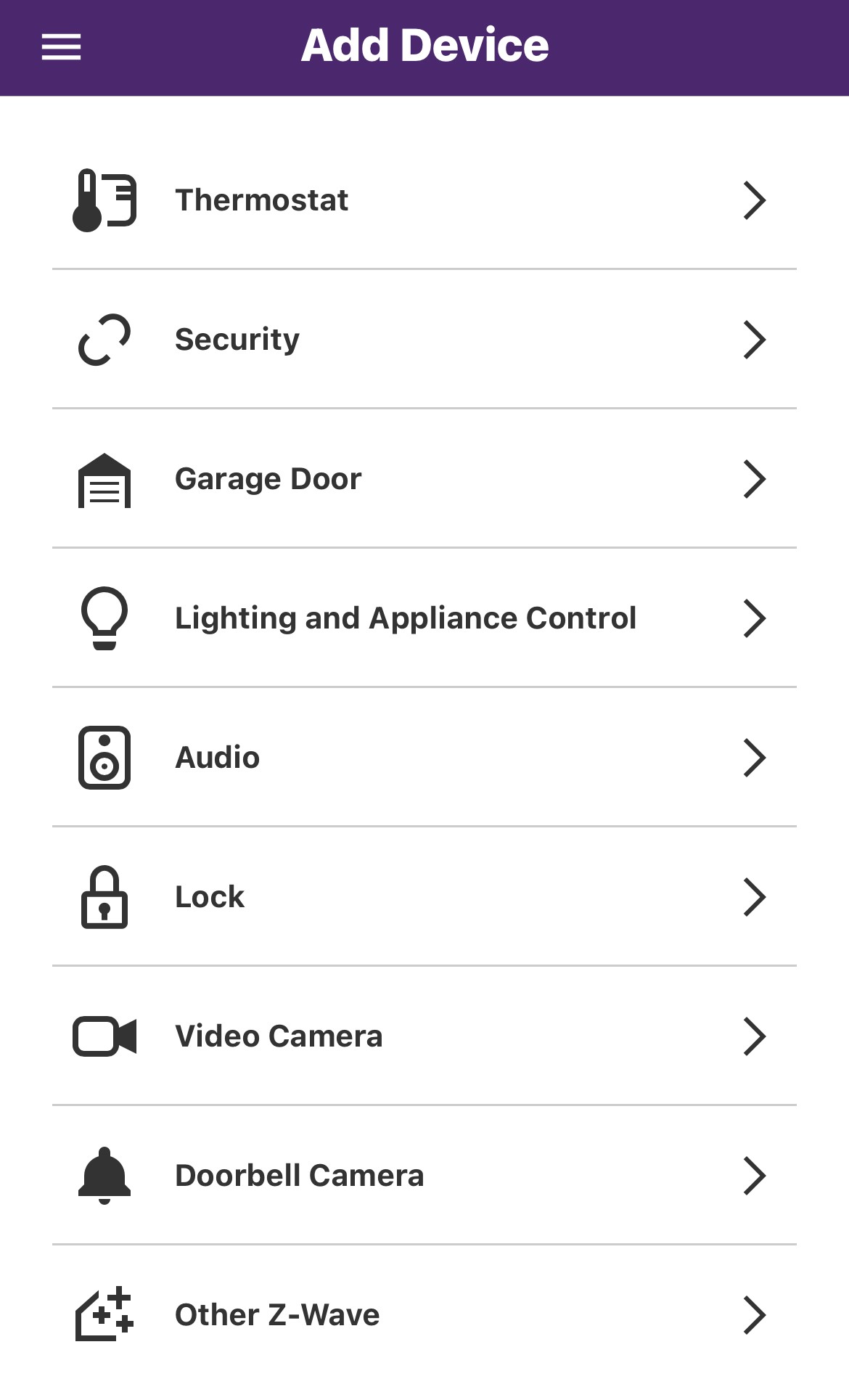

- Select Security
- Select your device and follow the on-screen instructions to complete the setup
