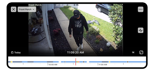

Stream footage is recorded using a Stream Video Recorder (SVR), SD card or an Onboard Recording rule at any time using Smart View. Playback of continuously recorded video is available using the customer website or customer app using Smart View.

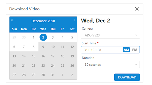

To access Smart View using the customer website
Click play button to stream the device's recorded video.
To access Smart View using the customer app
The requested clip will begin downloading on your computer.
To create an Onboard Recording rule using the customer app, follow the steps below:
24/7 HD footage is recorded locally on the camera with a microSD card. You can view live and recorded video on the Alarm.com website and mobile app from anywhere using the SmartView video timeline to search for important events, such as a person detected or a door accessed and jump straight to the corresponding footage.

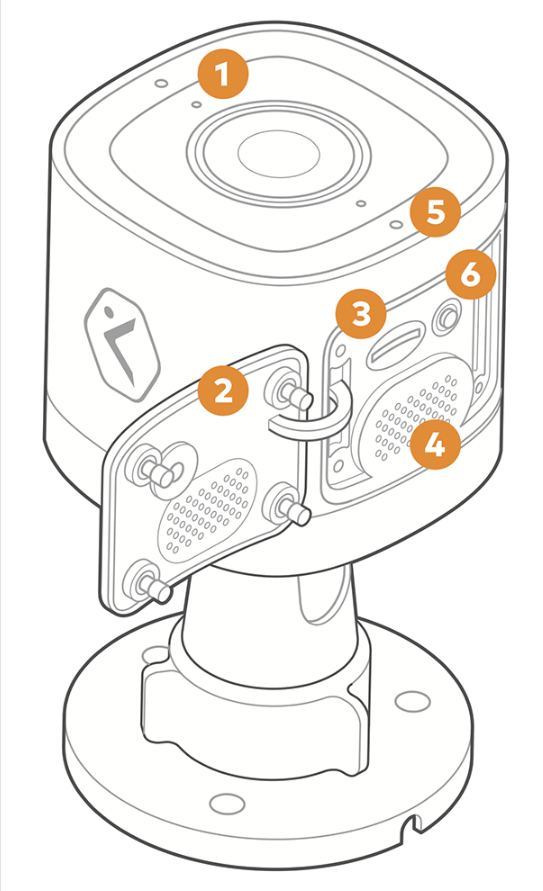

Steps to factory reset the ADC 724X camera:
Where can I find the reset button?
The reset button
R
is on the main circuit board. The reset button’s location on the ADC 724X camera is shown in the reference guide image below.
Reference guide for the ADC 724X camera

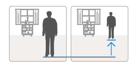

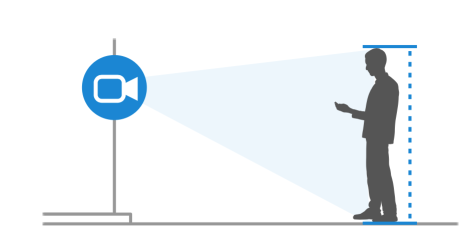

Calibration best practices
Verify that the person's entire body is in the field of view for each photo.
After taking each photo, take a few steps backward relative to the field of view instead of side-to-side.
Use a mobile device instead of the customer website to make it easier to move around and take photos.
Users can use the customer app or website to calibrate certain video devices for video analytics. The calibration process involves taking five still images of a person in different locations visible to the camera.

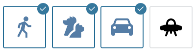

Video Analytics continuously scans a property and sends a notification when a person, vehicle or animal is identified. Advanced detection rules enhance perimeter security by sending alerts when someone is coming or going, or even loitering on the property.
With Video Analytics, enhanced notifications are sent with thumbnail images showing people, vehicles and animals. Advanced detection rules can also be used to draw virtual tripwires across driveways and virtual fenced-in zones for a property.
Email and text notifications can be sent whenever the following example events occur:

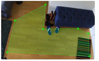

To configure a
Ground Zone
rule, follow the steps below:

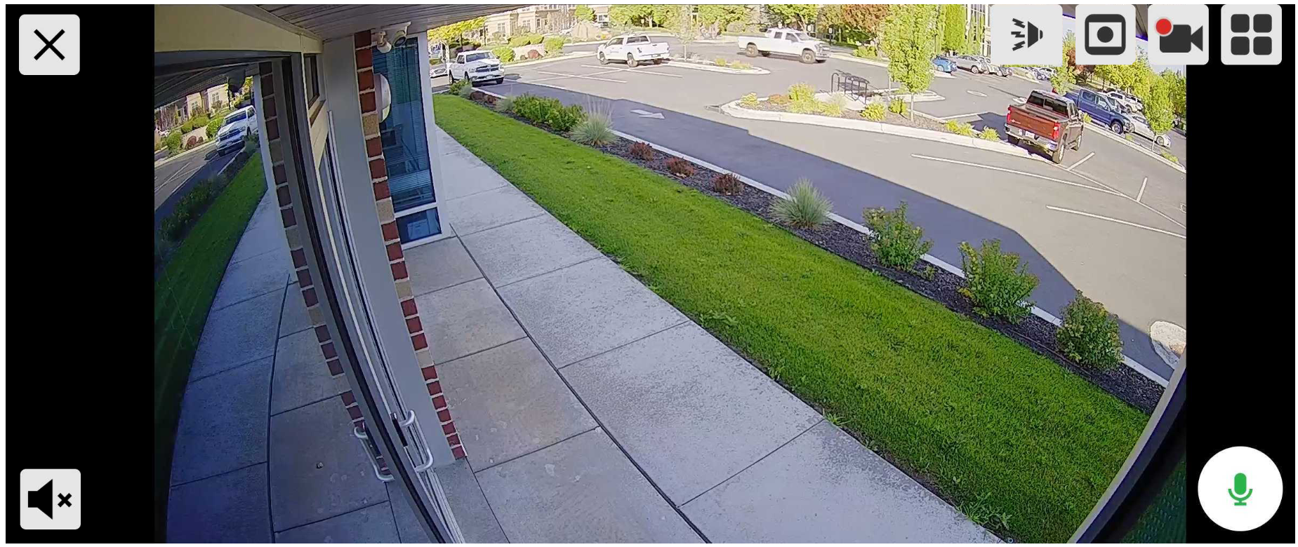

Two-Way Audio is designed so that only one channel is used at a time, similar to a two-way radio or walkie-talkie (i.e. incoming audio from the camera to the mobile device/customer website, or outgoing audio from the mobile device/customer website to the camera).
To enable/disable the speaker and microphone for an individual camera, follow these steps:
To talk/listen using the customer app, follow these steps:
To talk/listen using the customer website, follow these steps:

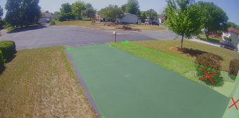

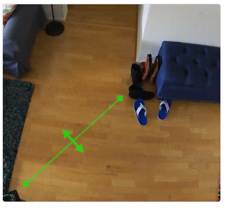

Avoid drawing Tripwires or Ground Zones over objects that might move by themselves (e.g. trees, bushes or other objects that move from the wind).
Only draw the rule where the feet or wheels of an object should cross.
Bad ground zone example
Including the bush and the garage door will make it difficult to identify objects. In this case, reduce the size of the ground zone to only include the driveway.
Good ground zone example
This is a good example as it excludes the bush and garage door.
