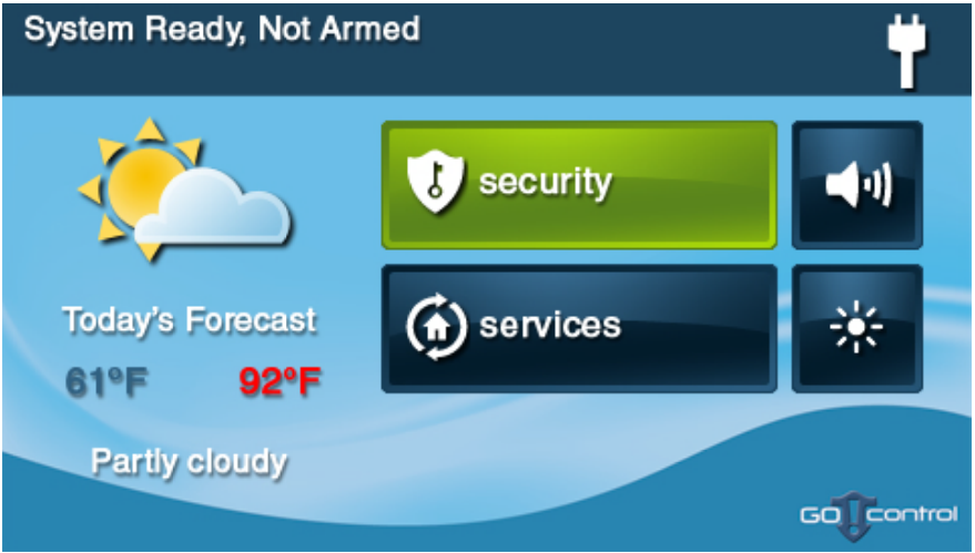

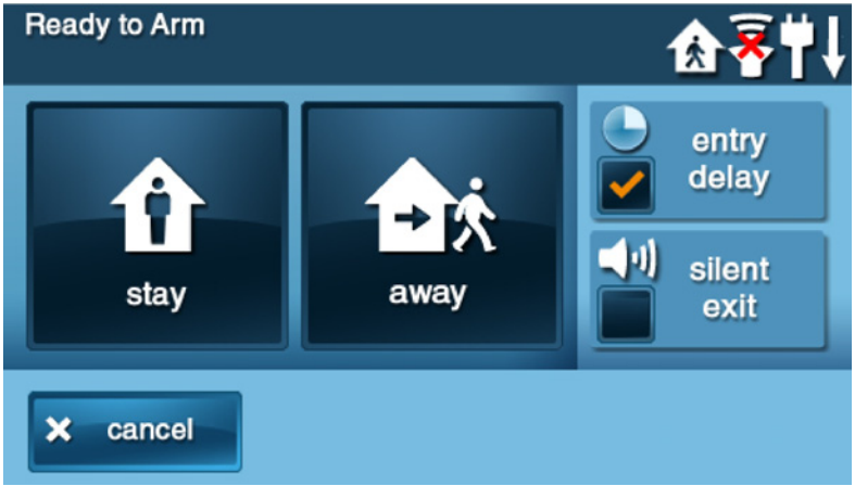

Arm your system
The
Ready to Arm
screen allows you to arm your panel in stay or away mode:
Select/unselect your entry delay if you want a 60s delay before the system is fully armed.
Stay
: Arming your system in
Stay mode
only arms the system perimeter only and is typically used during the night when occupants are sleeping.
Away
Away mode
arms all the sensors attached to your alarm system and is typically used when occupants are out of the home.

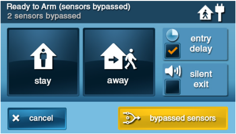

Bypassing sensors
All sensors must be closed before you are able to arm your system from the panel. Bypassed sensors offer no protection and cannot cause an alarm. Use bypass if you want to arm your system with one or more sensors open and intentionally unprotected.
Force bypass
At the security or menu screen, select the
yellow Arm button
At the Bypass screen, select
Bypass all
. This forces the system to bypass all the open sensors in the list, including any open interior sensors
Enter a valid user code to bypass the sensor
At the
Ready to Arm (Sensors Bypassed)
screen, select
Stay or Away

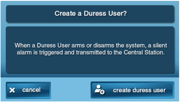

Duress codes
You can set up a duress code to transmit a silent alarm to the central monitoring station. Use the duress code when someone is forcing you to operate your security system against your will.
Setting up a duress code
On the User management screen of your panel, select the
User 8 (Duress) button
A confirmation screen will show up. Select
Create duress user
Enter a four-digit code as the new duress code. Select
OK
To confirm the duress code, type in the four-digit code from above
A confirmation screen will pop up. Select
OK
