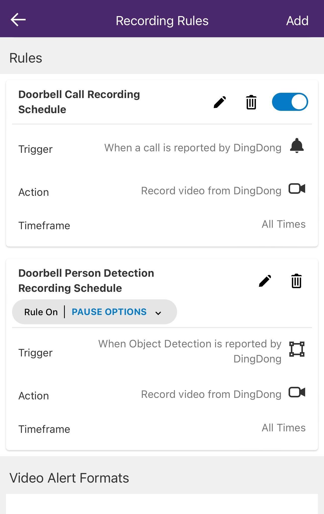

  5. Select
    Pause/Resume Recording Rules
    The TELUS SmartHome app and the Pause/Resume Recording Rules option highlighted under the Settings screen.
  6. Pause or resume your doorbell recording schedules by sliding the button for doorbell calls or selecting the pause option from the drop-down menu for motion or person detection rules.
    The TELUS SmartHome app and the Doorbell Call Recording Schedule and person detection settings shown on the Recording Rules screen.
