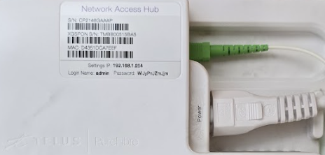

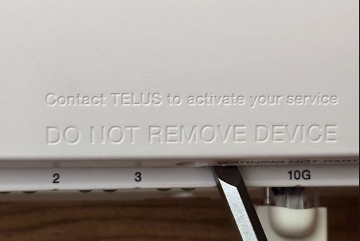

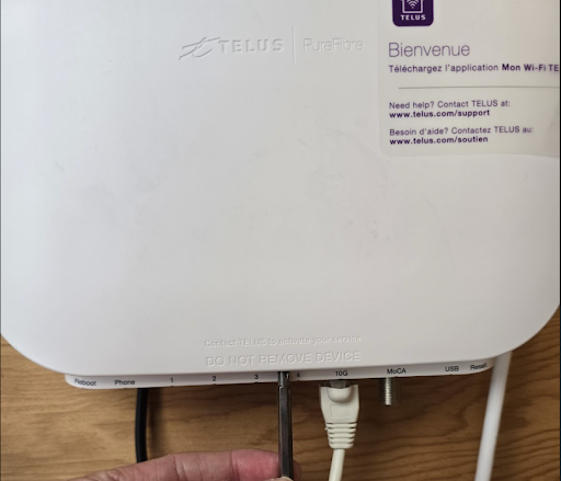

: Remove the top cover of your Network Access Hub (NAH) to locate your NAH login credentials.
  1. Remove the screw from the NAH cover.
    remove cover of network access hub
    remove screw of network access hub
  2. Take a picture of the label with the login name and password for easy reference.
    Login name and password on the network access hub

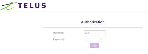

Step 3
  1. On the login page, enter the username "admin".
    Login page
  2. Enter the admin password on the device label of the TELUS Network Access Hub.

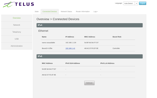

Step 4
  1. Navigate to
    Overview
    Connected Devices
    page.
    Connected devices menu
  2. Find the IP address of the Boost Wi-Fi 6 (Boostv2.1).
Step 5

  1. On the login page, enter the user name “admin”.
    Login page

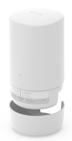

  2. Enter the admin password that’s at the bottom of the Boost v2 under the removable cover.
    Boost Wi-Fi 6” max-width=
Label on Boost Wi-Fi with login credentials

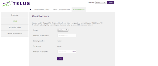

Step 7
: To enable or disable the Guest Network:
  1. Click on the
    Wi-Fi
    option on the left menu.
  2. Click on
    Guest network
    along the top.
  3. On the "Status" drop-down menu select
    Enabled
    , enter your preferred SSID and password and click on
    Save
    Create guest network
