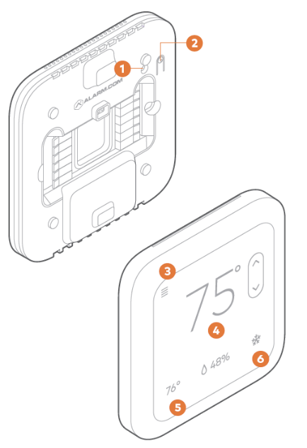

Reference guide for the smart HD thermostat operations
Thermostat and display
Status LED
Reset Button
Settings menu
Current setpoint
Indoor temperature
Current mode
