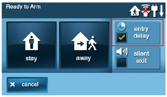

Arm your system
The
Ready to Arm
screen allows you to arm your panel in stay or away mode:
Stay
: Arming your system in Stay mode only arms the system perimeter and is typically used during the night when occupants are sleeping.
Away
: Arming your system in Away mode arms all the sensors attached to your alarm system and is typically used when occupants are out of the home.
You can select the
entry delay checkbox
if you want a 60 second delay before the system is fully armed.

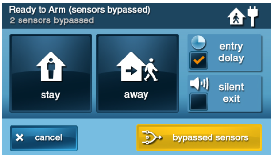

Bypassing sensors
All sensors must be closed before you are able to arm your system from the panel. Bypassed sensors offer no protection and cannot cause an alarm. Use bypass if you want to arm your system with one or more sensors open and intentionally unprotected.
How to force bypass:
From the security or menu screen, select the
yellow Arm button
From the Bypass screen, select
Bypass all
. This forces the system to bypass all the open sensors in the list, including any open interior sensors
Enter a valid
user code
to bypass the sensor
From the Ready to Arm (Sensors Bypassed) screen, select
Stay
or
Away
Note
: Force bypasses are automatically removed when the system is disarmed.
