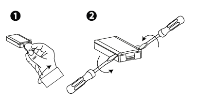

Insert a coin in the slot and twist to remove the cover. If a coin is not available, insert a 4mm flat screwdriver into each slot of the plastic cover and twist to open each side
