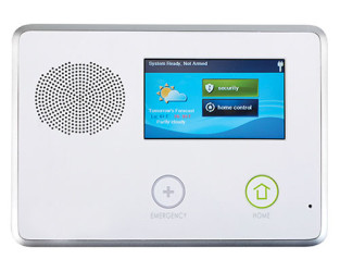

Before you begin, disarm and power down your panel.
Locate and remove the screw on the top of the keypad.
Gently pull down the front cover down. Do not let go of the cover when removing the front from the panel.
Locate the third hand (a plastic piece resembling an upside down “V”) and place it over the notch in the centre of the cover. This will allow the front cover to gently hold onto the panel.
Locate the green battery pack and remove the clip that connects the battery’s red and black wire to the circuit board.
Remove the original battery. You may use your flathead screwdriver to gently remove the battery from its place.
Insert the new 2GIG panel battery and plug back in the clip.
Unhook the third hand and close the cover. Press the cover to the panel shut until it snaps into place.
Replace the screws at the top of the keypad and let panel charge for 24 hours.
